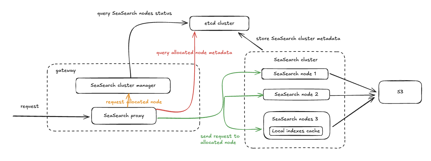

Cluster architecture
A SeaSearch cluster deployment consists of SeaSearch nodes (recommended more than three nodes for high availability), and gateway node(s). These nodes coordinate internal state and index allocation through etcd:
  • The SeaSearch node is responsible for reading and writing the index. The index is temporarily stored on the local disk as a cache. If the required data is not in the cache, it is read from S3. When a SeaSearch node goes offline, its indexes are reassigned to the remaining nodes, which then retrieve the latest data from S3.
  • The gateway node mainly consists of two processes: the SeaSearch cluster-manager service and the SeaSearch proxy service. The former monitors the health of the Seasearch nodes and assigns the most suitable node to new requests. The latter queries etcd for the metadata information of the most suitable node assigned by the cluster-manager and uses this metadata information to forward user requests to that node.

  • Deployment method 1: single gateway (for most situations)
    In most cases, deploying just one gateway node is sufficient to handle user needs within a SeaSearch cluster. At this time, both the SeaSearch cluster-manager and SeaSearch proxy services on the gateway node are enabled:
    grafik

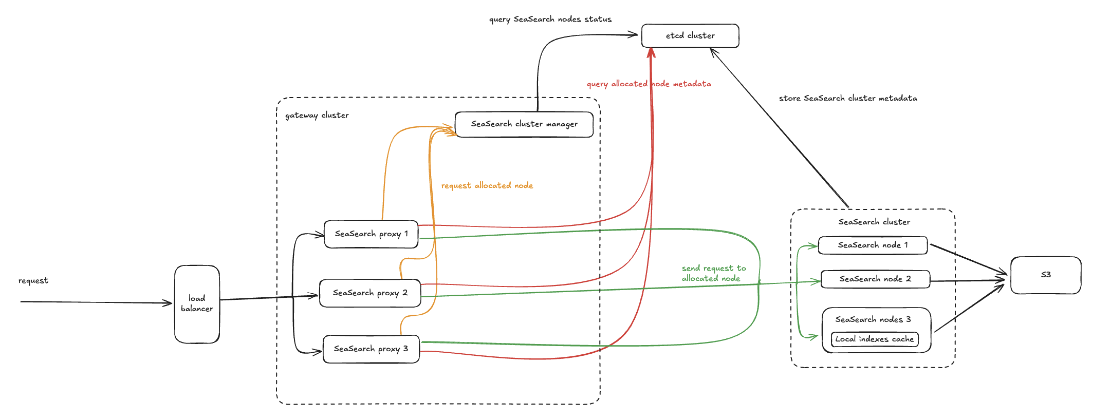

  • Deployment method 2: SeaSearch gateway cluster
    In addition to the main SeaSearch service, the SeaSearch gateway also supports clustering (i.e., SeaSearch gateway cluster) to achieve load balancing for higher demand. The SeaSearch gateway cluster mainly consists of several SeaSearch proxy nodes (more than 3 are recommended for high availability) and one SeaSearch cluster manager node:
    grafik

External load balancer for SeaSearch gateway cluster
Since the access endpoint for the SeaSearch cluster is the address of the proxy service in the gateway, you also need to configure load balancing for multiple proxy services to enable external connections for the SeaSearch gateway cluster. Here, we will use Nginx as an example to briefly describe how to configure Nginx to access the SeaSearch gateway cluster in this scenario:
